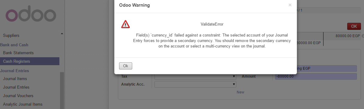

At Odoo, I want every cash transaction -whether cash in or cash out- to go only through a cash box in Cash Registers.
I made a purchase for a foreign currency (USD) other than my default functional currency(EGP), when reconcile i put that foreign currency cash account, but it didn't reconciled, it bring up a ValidateError:
Field(s) `currency_id` failed against a constraint: The selected account of your Journal Entry forces to provide a secondary currency. You should remove the secondary currency on the account or select a multi-currency view on the journal.
I configured the journals as follows:
- Cash journal (EGP): Currency is: EGP, the secondary currency of the selected account for the journal is: EGP
- Cash journal (USD): Currency is: USD, the secondary currency of the selected account for the journal is: USD
Can you help me please
